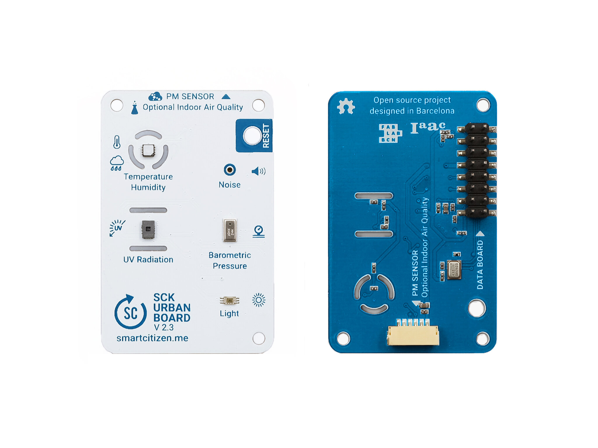

The most popular one of these boards are the Urban Boards. These boards offer a selection of low-cost sensors in a board ready to measure the urban environment: temperature, humidity, noise, light, and PM2.5, among others. Together with the Data Board, and a PM sensor, they create the Smart Citizen Kit.

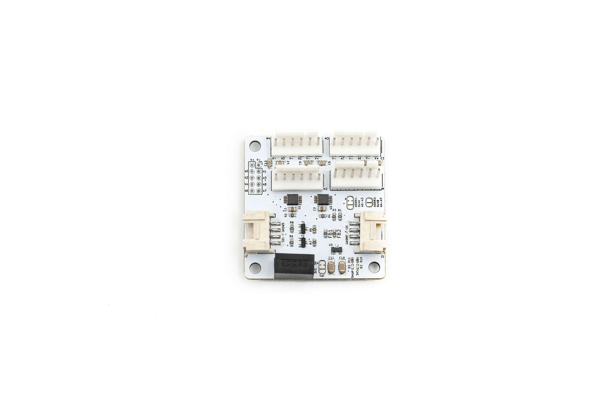

- Analog Sensors Board: An auxiliary board using two high-resolution Analog to Digital Converters (ADCs) capable of reading 8 analog channels at 16 bit resolution. It is used in the Smart Citizen Stations for the interfacing with sensors such as electrochemical cells or PIDs.

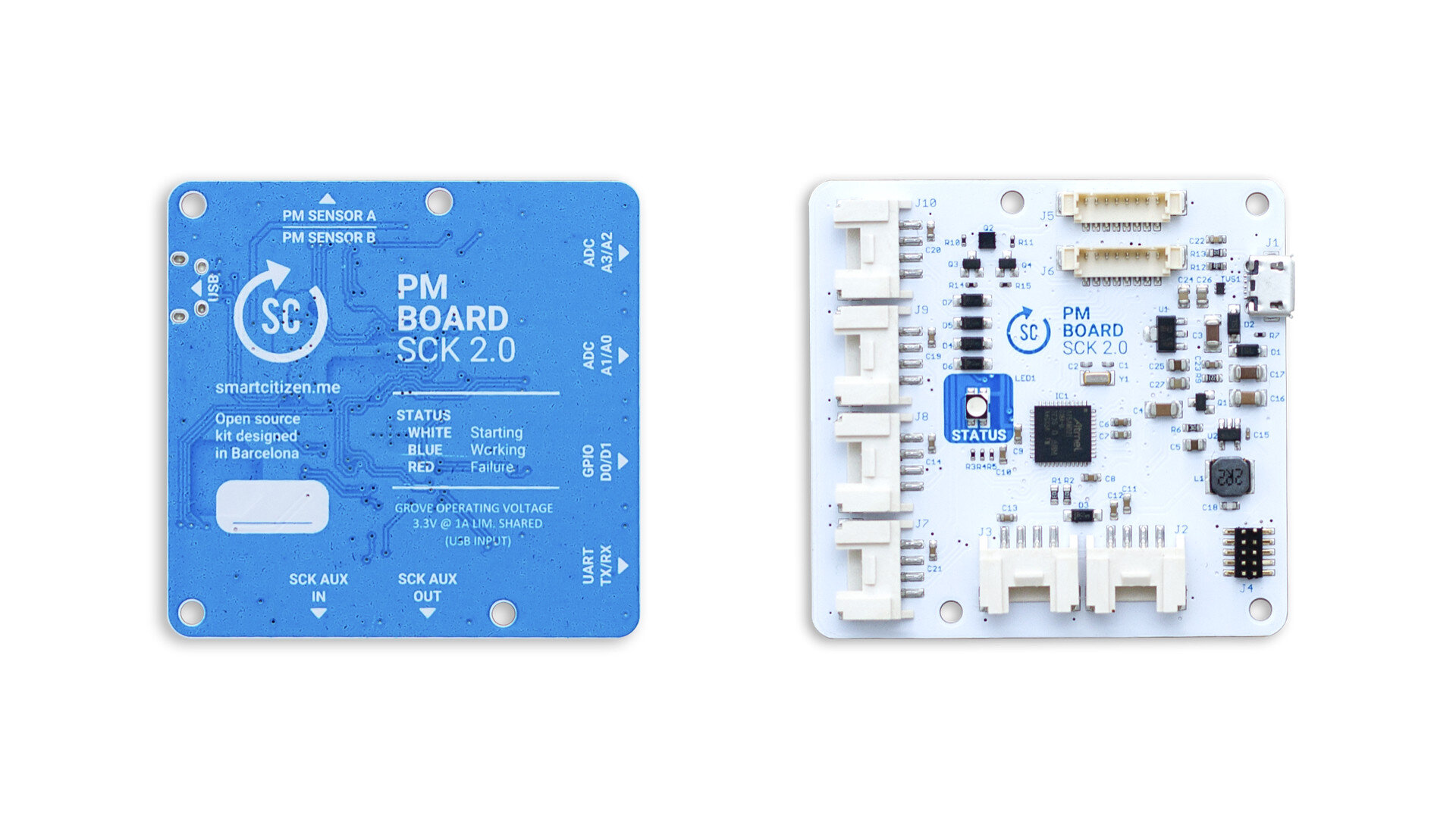

- PM Sensor Board: An auxiliary board capable of driving two PMS5003 Particulate Matter sensors as well as other auxiliary sensors required for specific deployments. It is generally used in the big Smart Citizen Stations.
