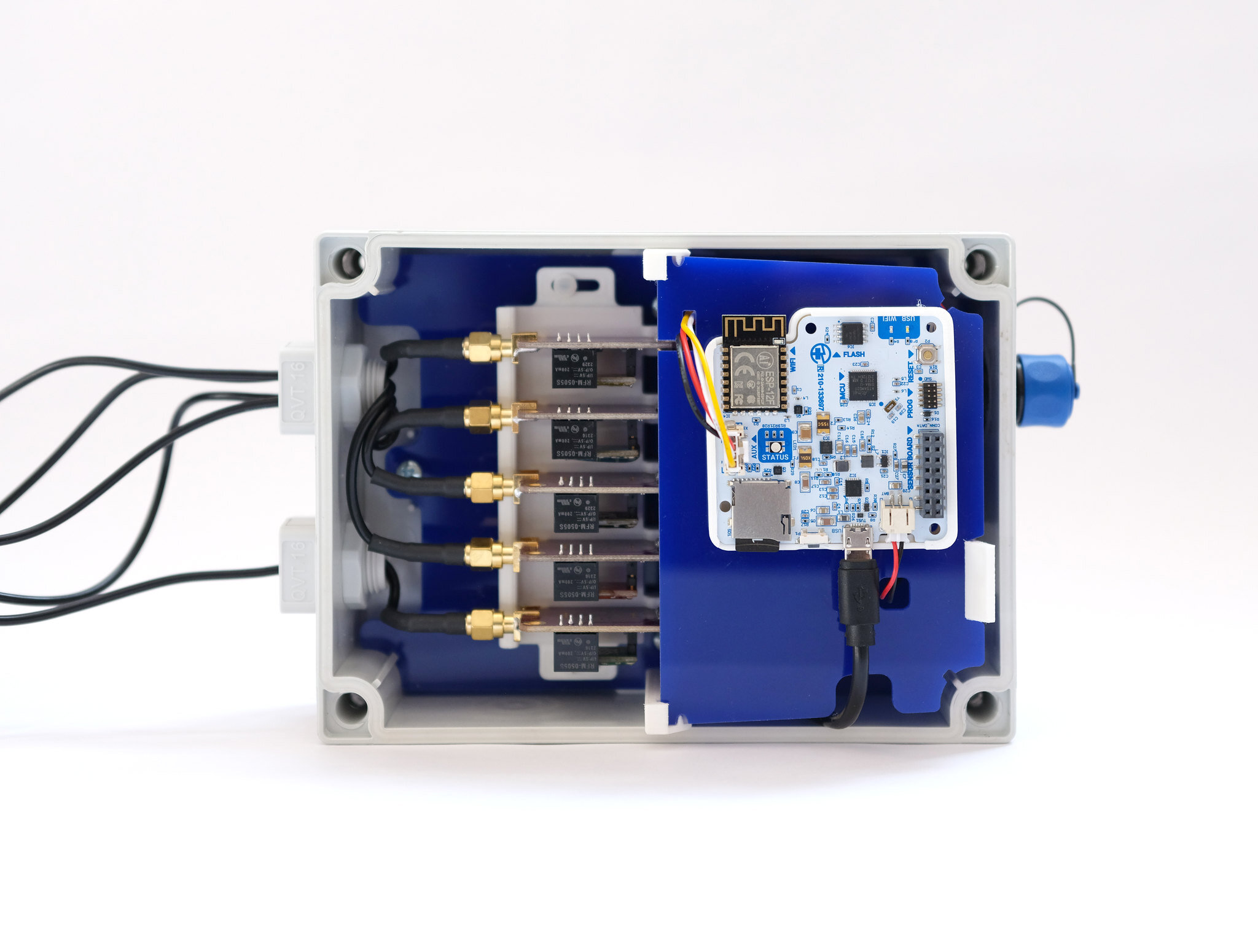

Multi-Sensor Water Station¶
Grade: advanced
The Water Station is a multiparametric water unit, capable of measuring pH, Temperature, Dissolved Oxygen, Conductivity and ORP.
