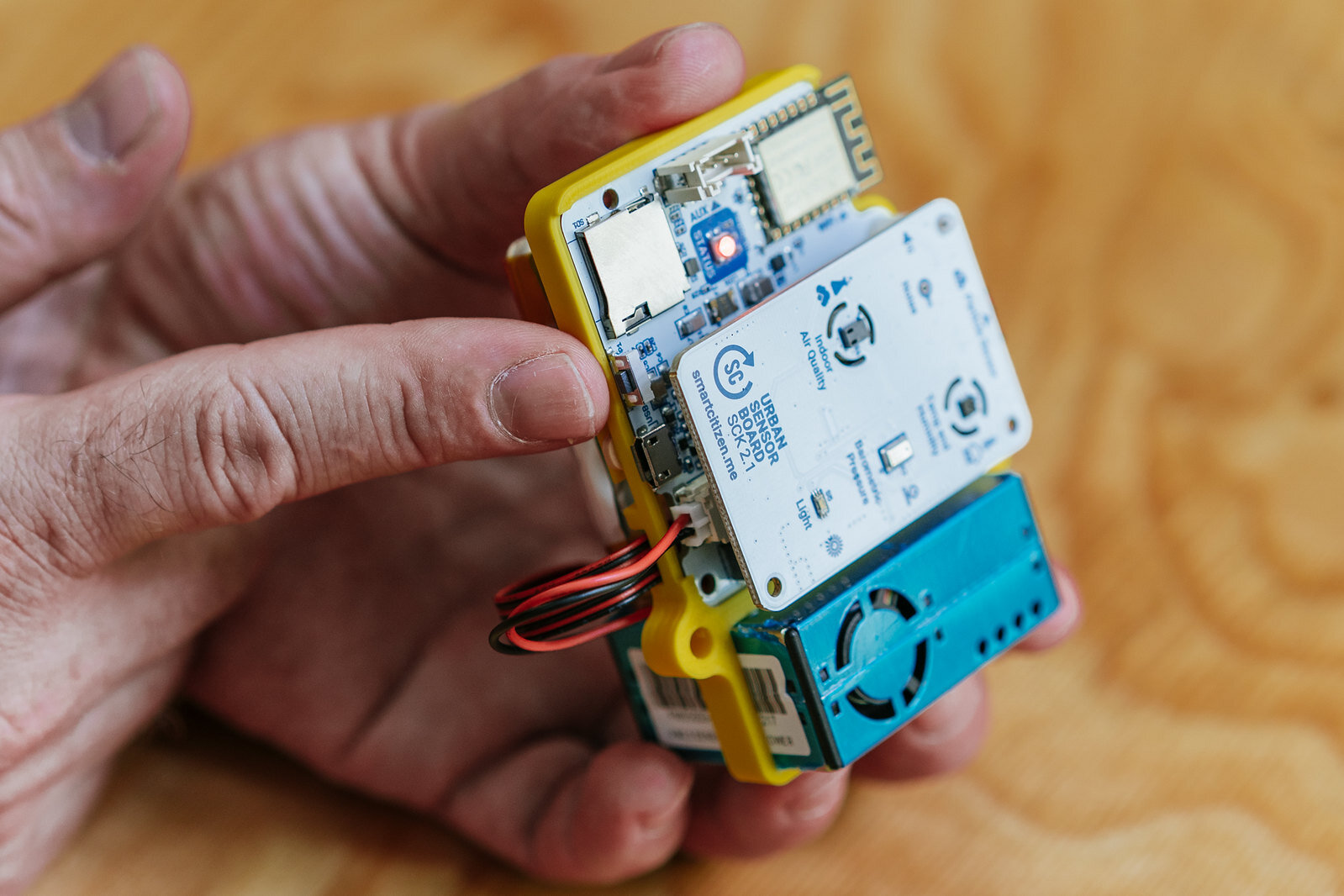

- Press the ON/OFF button once. The LED should be breathing RED.
- Connect to the network
SmartCitizen[...]and set it up again to log inSD card mode.
The network won't show up¶
Before configuring the Kit, if the SmartCitizen[...] network doesn't show up, make sure the LED is red. If not, press the button until the LED turns red.
