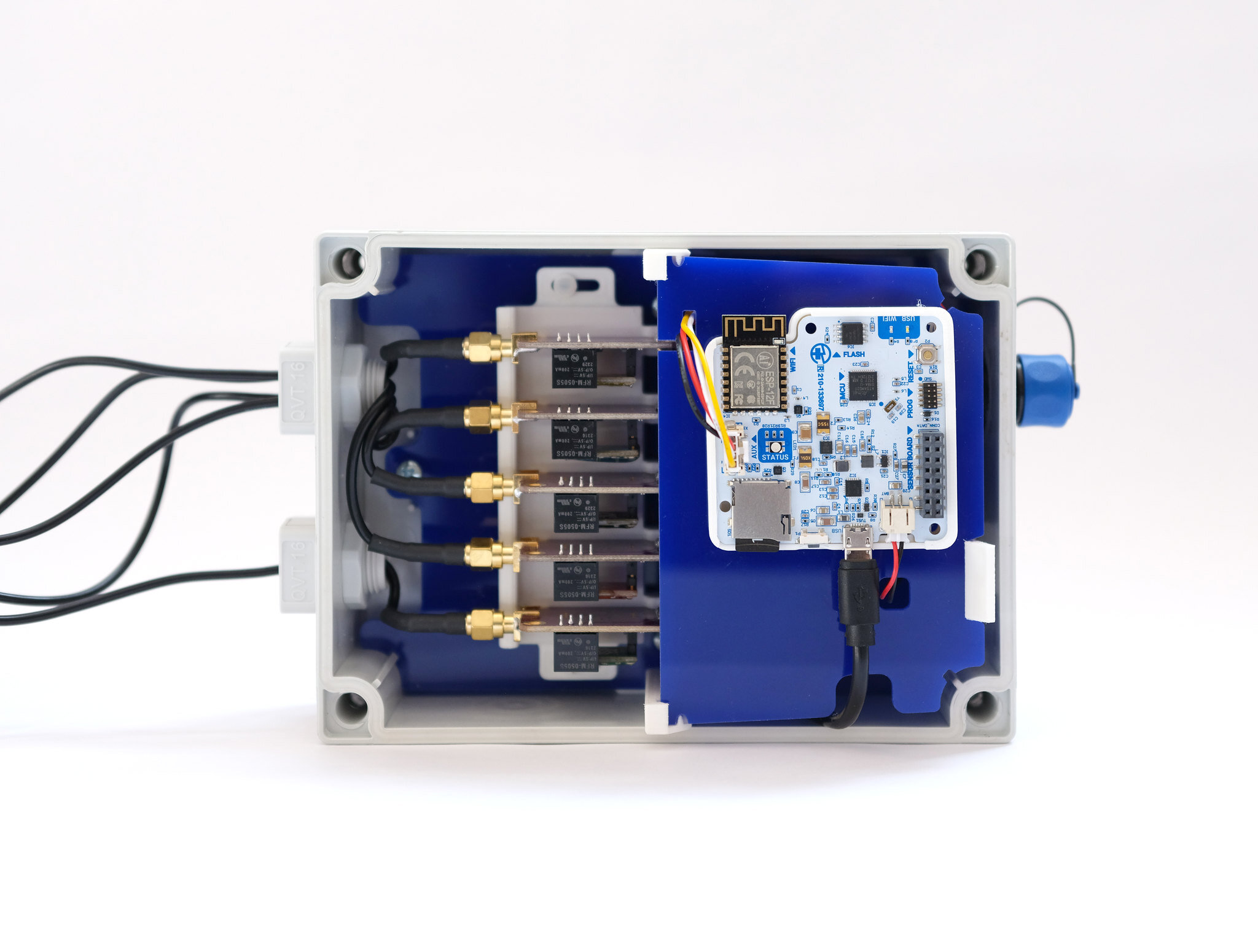

Soil and Water¶
Another common use case is the measurement of physico-chemical parameters in water. These parameters are measured with specialised sensor probes that can measure pH, water temperature, conductivity, or dissolved oxygen. We have generally worked with Atlas Scientific probes, which use dedicated drivers to interface with those probes. The Data Board can directly interface with those drivers via I2C through the auxiliary port.
There are various possible configurations for water measurements. Typically, we have built multi-parametric units, but simpler units are possible with one or two probes. All the different configurations are modular and can include more or less probes depending on the particular needs. Some interface boards, like the Analog Sensor Board, can also be used in this context to read analog turbidimetry sensors or water level sensors, for instance.
