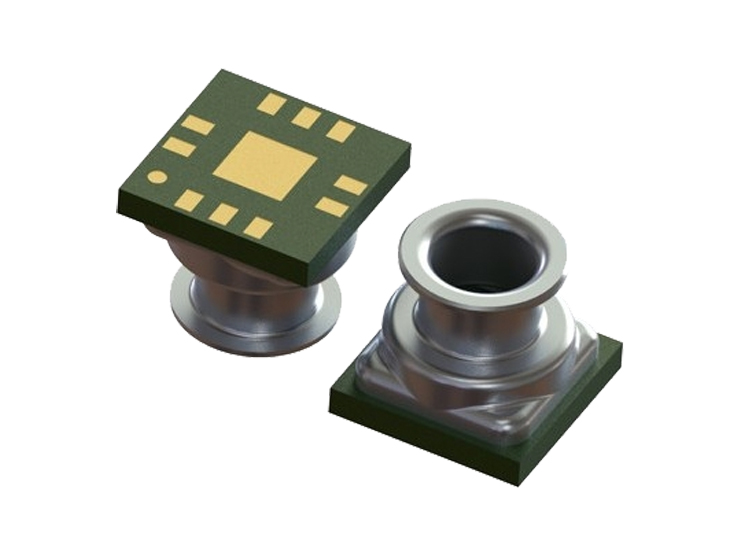

ST LPS33K¶
A compact barometric pressure sensor. Available in SCK2.2.
Image Credit: STMicroelectronics
