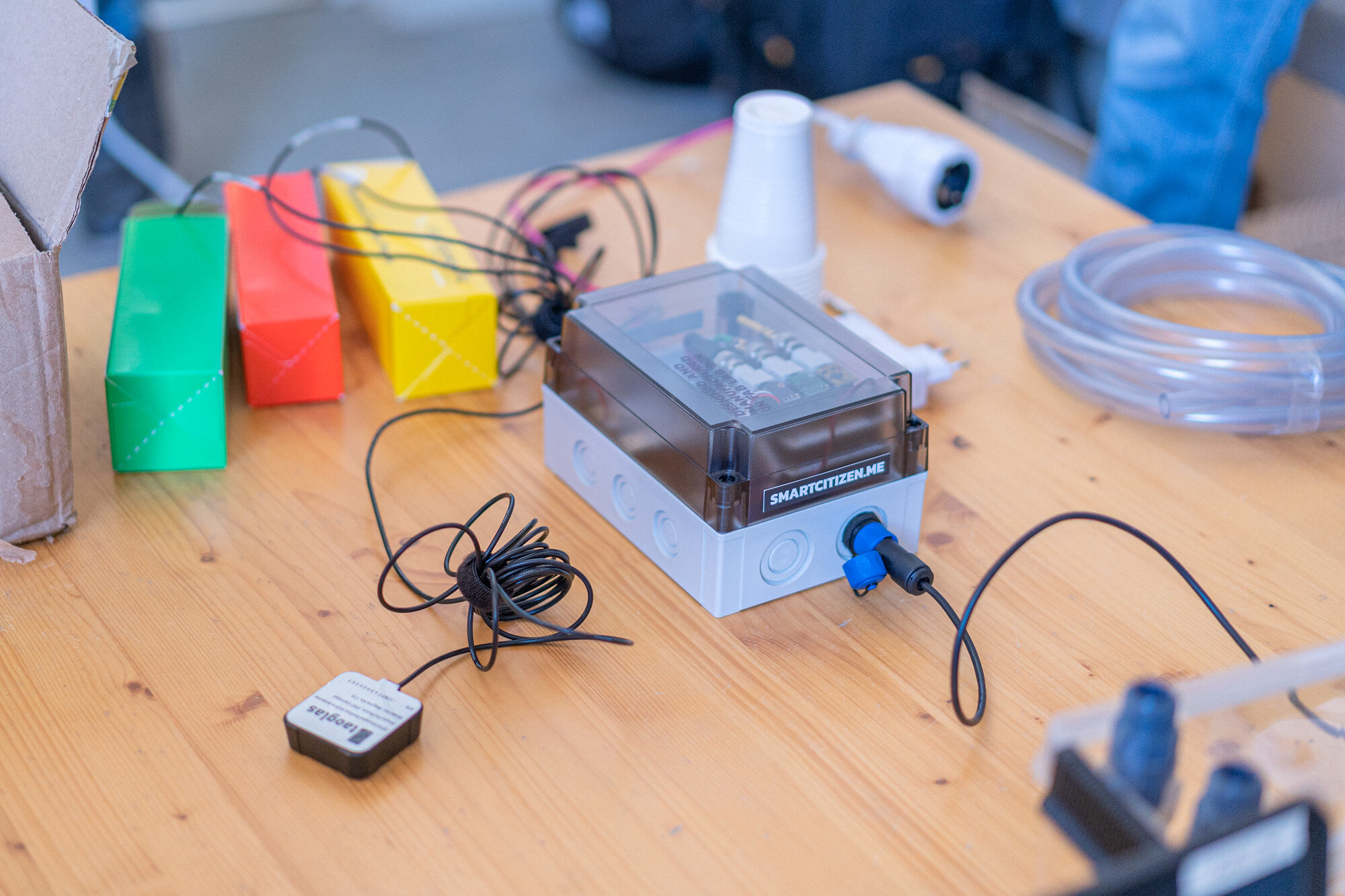

Although most of our work is with air quality sensors and other related metrics, we also work with water metrics. This section summarises our integration of water sensors, in some cases, with interchangeable probes or drivers for soil measurements. For example, the setup shown below is designed for water measurements and includes Atlas Scientific temperature, conductivity, and pH probes, as well as a GPS.

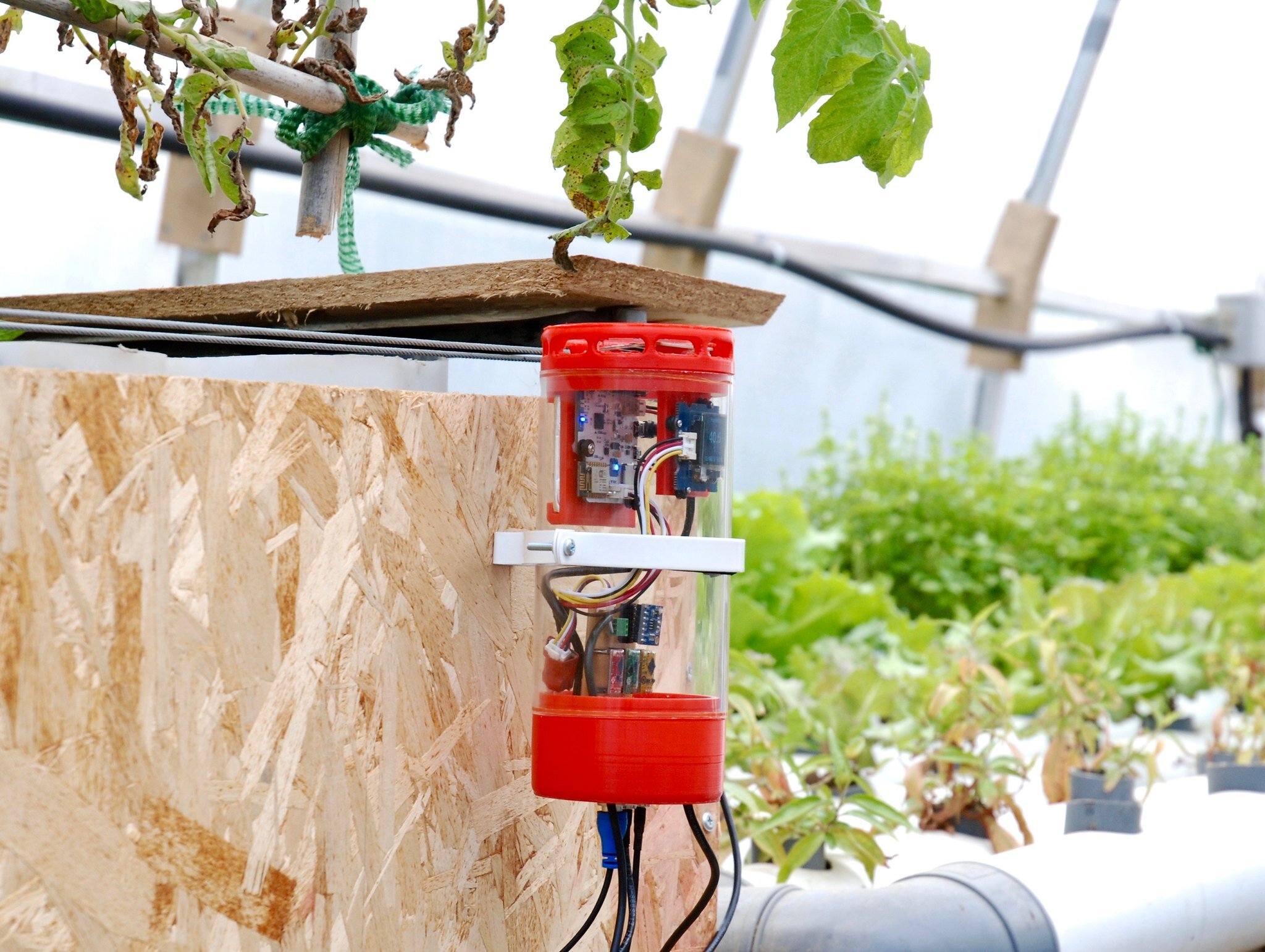

Below you will find some legacy (aka development) versions. These are left here for you to identify them, or in case you want some inspiration.
Through a collaboration with Aquapioneers, we designed the custom enclosure below.
